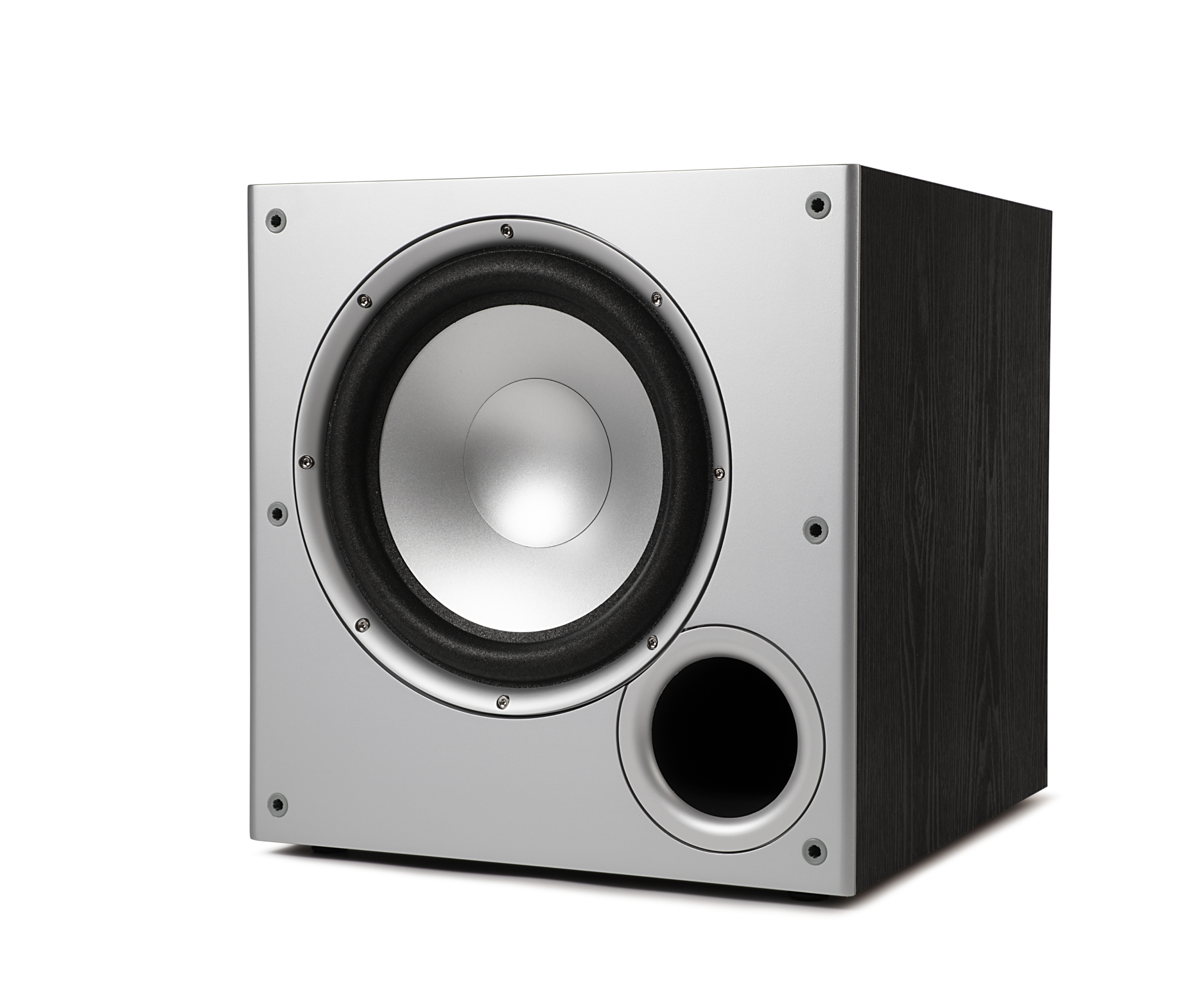

Hi George, thanks for the loudspeaker suggestion!
