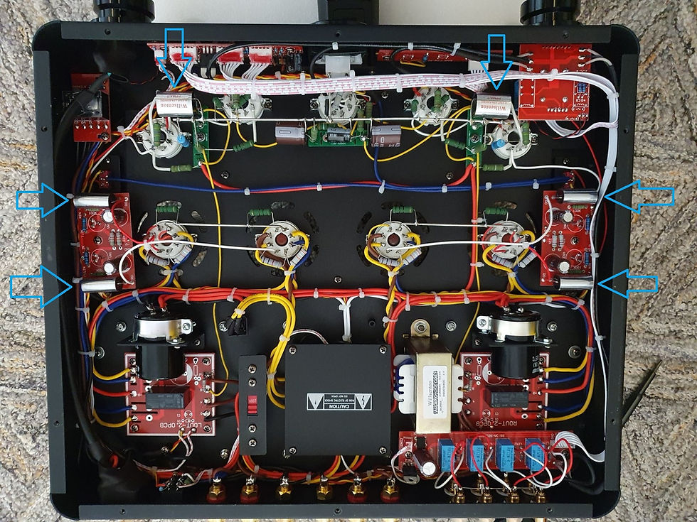

Did you try swapping all the L/R channel tubes? Try the front 6SL7s, if no change swap the 6SN7s, still no change then swap the KT88s. If the squeal switches side then swap just one KT88 to determine which tube is the problem. If swaping tubes achieves nothing, then it must be something internal failing - I would look at the Willsenton branded caps first.
